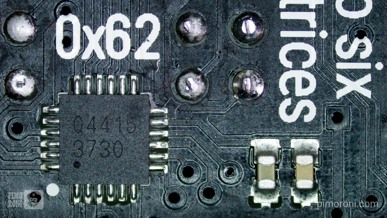

The board uses three IS31FL3730 matrix driver chips, each driving two of the matrix displays. The IS31FL3730 matrix driver is the same chip that we use to drive our Flotilla matrix module, and it talks to the Pi over I2C. We've set each driver chip to have a different, consecutive I2C address: 0x61, 0x62, and 0x63.

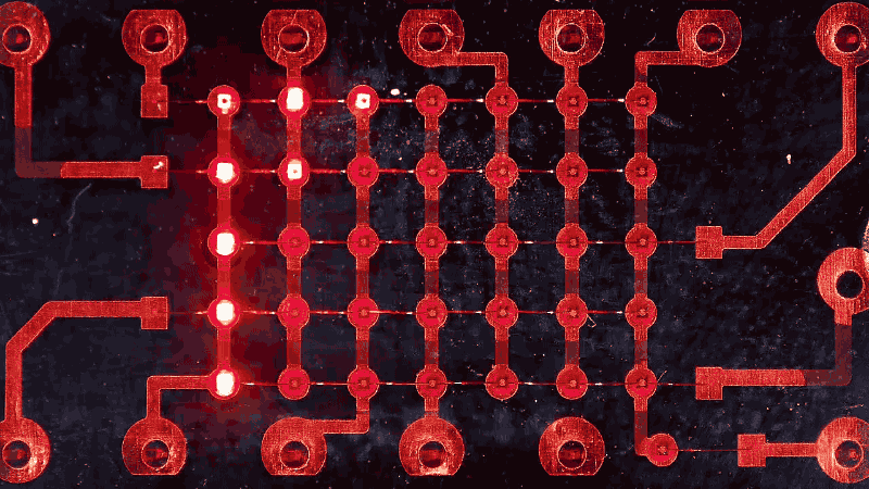

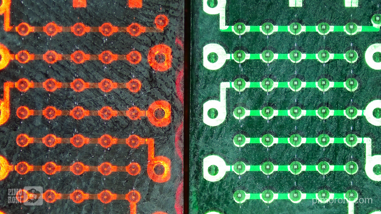

The displays themselves have 5x7 pixels, plus a decimal point, and the LEDs on them are multiplexed, as opposed to charlieplexed. Because the diodes are biased in different ways across the rows and columns, individual LEDs can be lit by applying voltage in the correct direction to an intersection of a given row and column. You can see the wires connecting the LEDs in the image below

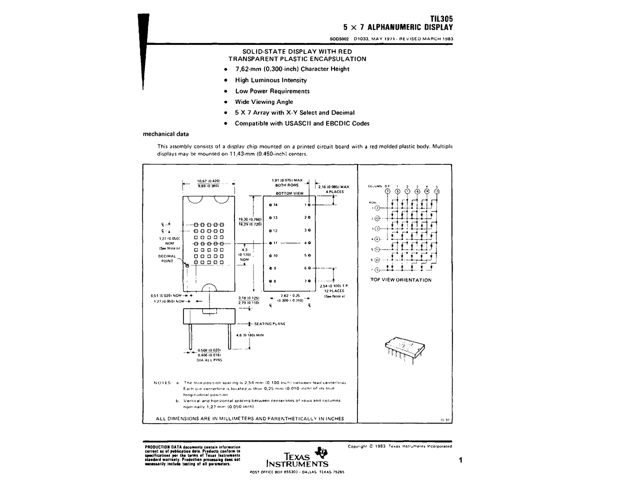

The LTP-305 displays were originally made by Texas Instruments, before being manufactured by Lite-On, and you can see an excerpt from the original Texas Instruments datasheet below. They certainly have some heritage!

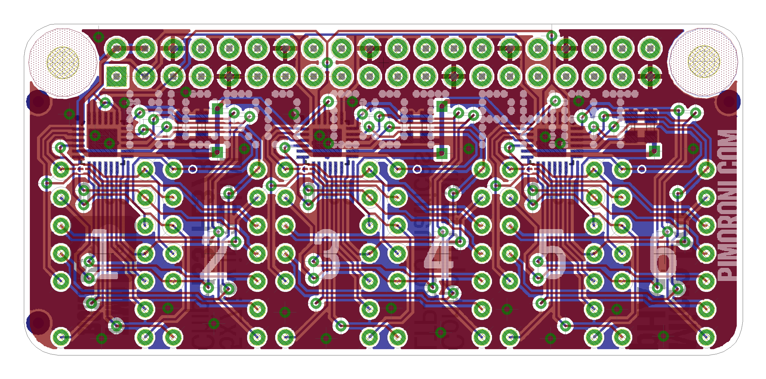

The design of the PCB in Eagle took Phil a few days, as routing all of the connections between six displays and three driver chips was tricky, to say the least.
Paul put together some suitably retro silkscreen, with the product name in the Scoreboard typeface and helpfully labelled all of the salient information, like display numbers and driver chip I2C addresses.
Phil sent off for the first set of prototypes from Dirty PCBs, and a week or so later they arrived. There were a couple of issues that needed addressing. The first was that the through-holes for the displays were a pretty tight fit, although they did fit. The second was that there was some noise in the data being sent to the displays, resulting in some garbling.
The second set of prototypes came from Eurocircuits, as we often do, and Phil widened the through-holes, moved the decoupling caps closer to the displays to reduce noise, and re-routed things to make it a bit neater. This spin hit the nail on the head, so we went ahead and ordered the production PCBs.
